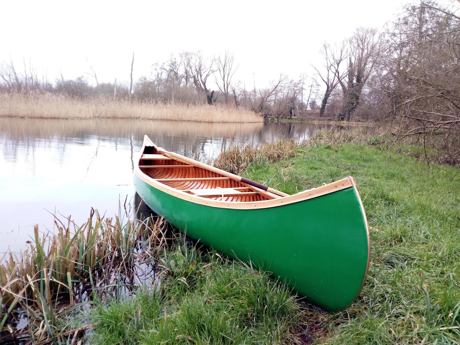

My Rushton Navahoe is essentially a B grade Indian girl with less pronounced upsweep at the shear and lower quality materials.
AD_4nXf0JFcMBRD_yHYzhJSaHRqvTB5uNxH8v9t8yUvOon3Wkqzj0iUOEkp5P2uzxKazKNvBSteF-kgT6EhWIi7tdaT41WbPACglB3hylWuyP-GCK6cheyw0yhfwDFRrd-FDRhFTAPz62Q

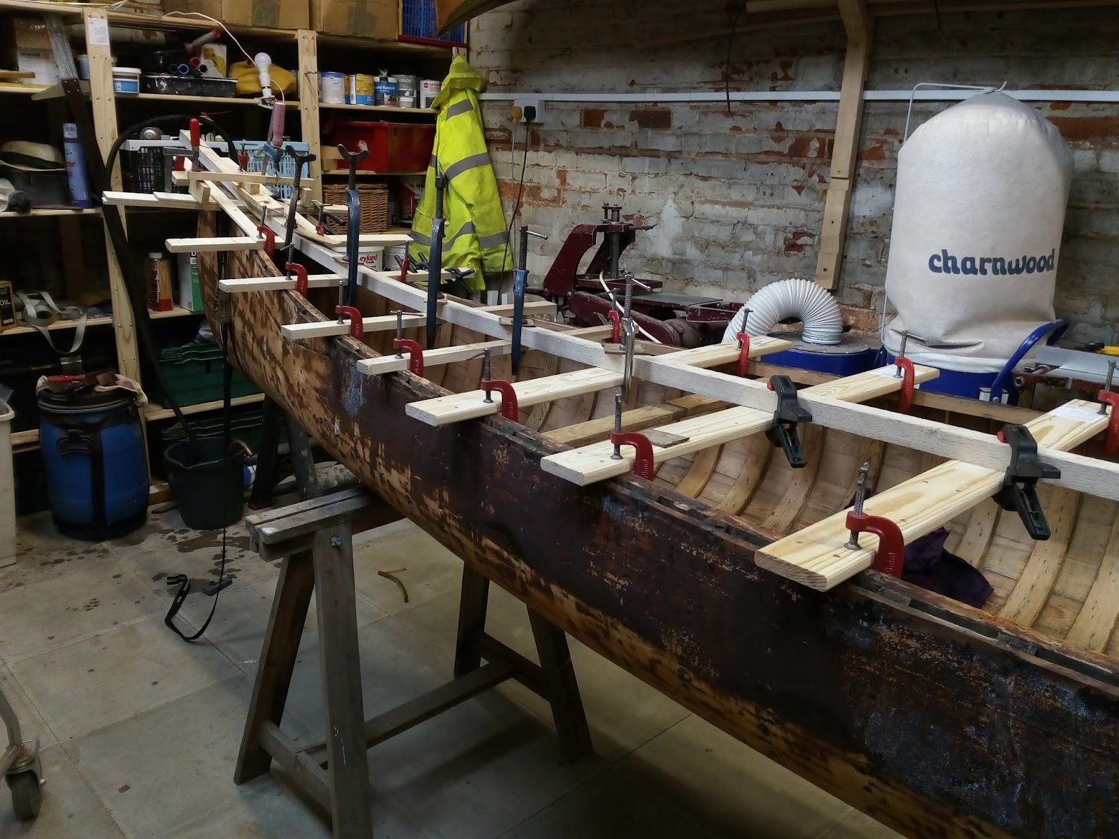

The thwarts are oak, the rails spruce and the rail covers are ash.
As Mark says, bending the rail covers is not an easy task. As I could not get full length ash for the rail covers I had to scarf two pieces on each side in any case. After unsuccessfully trying to bend the thin pieces of the side covers against their natural inclination, I came up with the idea of bending the upweep for all four pieces at the same time by bending a wider piece along the centre line of the boat, then splitting this into the four pieces I needed, which were then scarfed together. This worked a treat.
AD_4nXfsA8Y0d1XGtRlMT5fJKTOW1CwxCFL7q155mrrn16U4xET453d59L36FUJPIj1Am8-hjGgKh-haLJ_6xAjDYrpis7jy1zvtHAU8acC8KVrDEMidHrvqDWK55Jr50Xe6kHN1fDonGw
The bend on the top cover was not as extreme so I did each quarter individually.

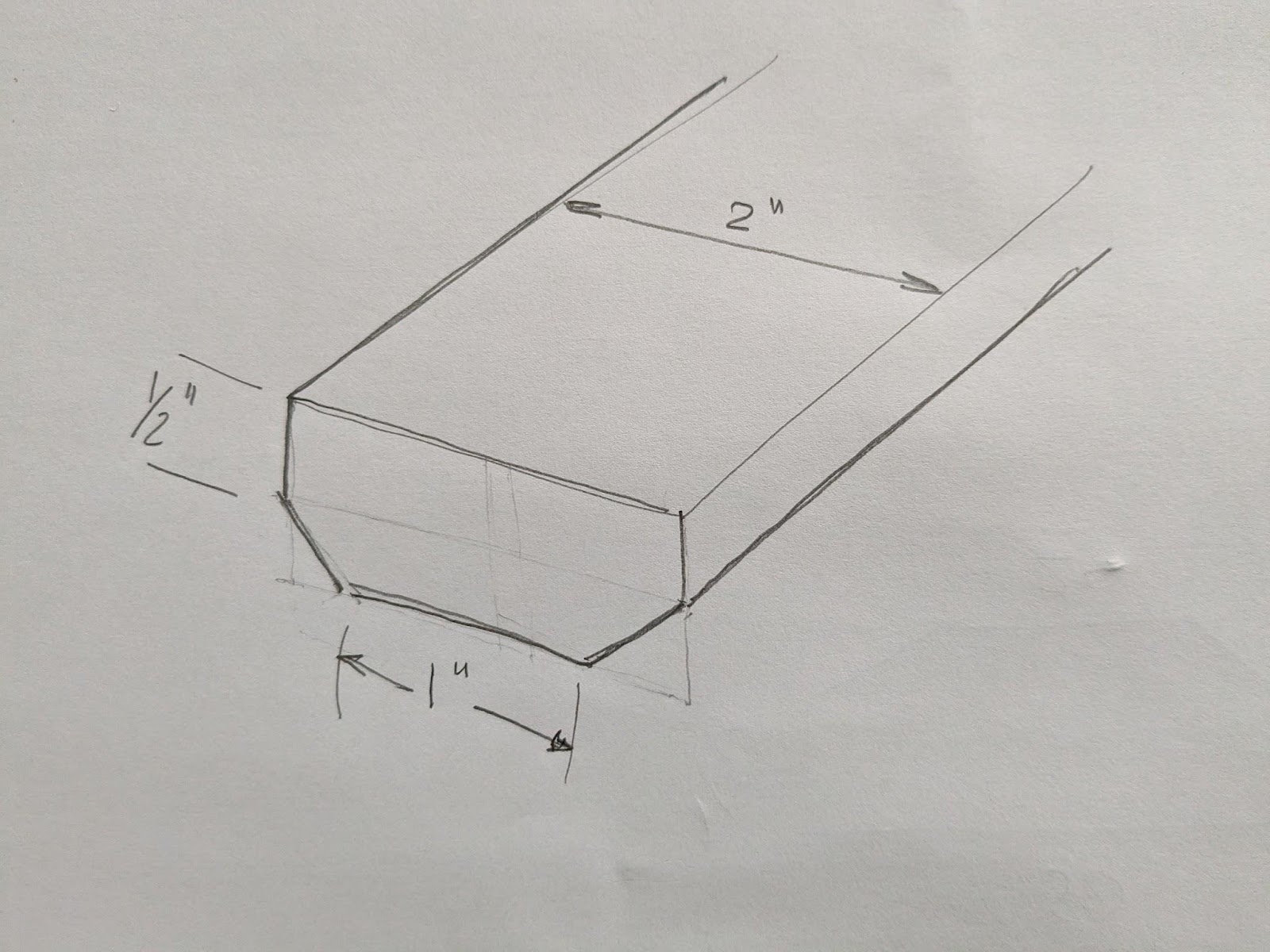

The ‘plain’ thwarts are actually shaped underneath:
AD_4nXcRijX0XCaEb5lE3wo2oVZ1vYgxpWXpHug4oSyyU2KhmBqBU3osYF5NtKFWcGJVmXa9Q2Np7WpmeS64uWlY1-J4hINHfjda20SRjeInQDJUtvFBWd5O4d1gXstR70iNQUPn4OPUCg
Sam
Yes, Sam's drawing is the three sided design of the bottom of the thwarts I was referring to. Jim, I believe the serial number is 2801, going from memory I'll check to be sure. Again from memory both stems are stamped JH Rushton Canton NY. I'll double check but if you don't hear from me tomorrow I remembered correctly.
