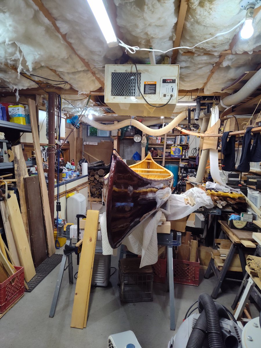

After a good sanding of the first coat of Epifanes, I moved the canoe into my basement shop (12 ½' x 26') since it is the only conditioned space I have available (a dehumidifier and space heater). I was able to keep the shop at about 65-70 degrees and 50-55% humidity. Certainly not spacious, but I can get atound the entire boat with good lighting. After a thorough vacuuming to remove as many sources of dust as possible I had a fairly “clean” space.

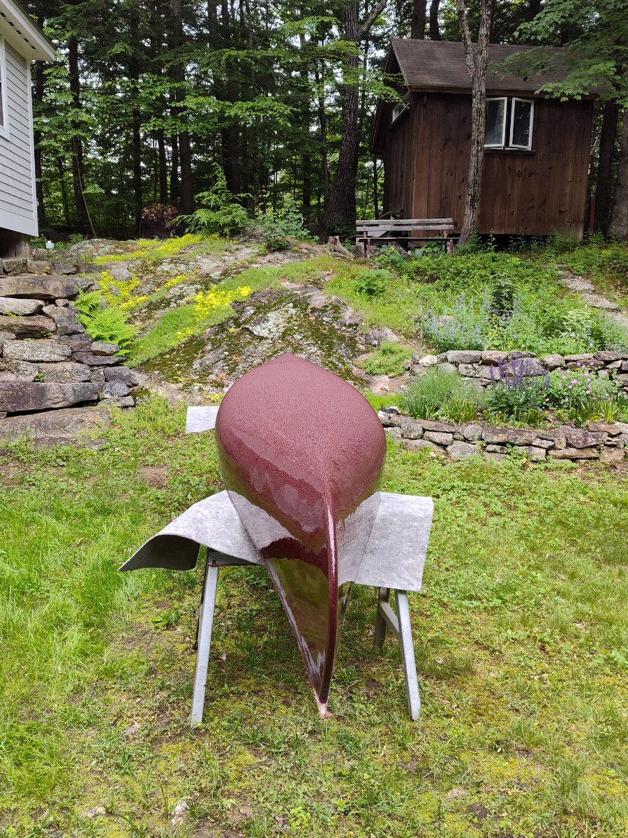

Epifanes Deep Red thinned with Interlux 333, about 5%, worked well with a foam roller and tipped with a brush. As described in the Webb article, I worked on about 2' on one side then the other side up the length of the canoe. I have the canoe outside awaiting a light wet sanding, mother nature is helping with the wet part, then back in for a third coat.

No! Epifanes performs brilliantly low 60’s temperature! Critical! Flow is so much better low temps, slows drying time! Do not paint on a warm humid day! At least the last coat. Folks wait for the warm weather to paint and it’s an enemy of a good paint job.

Chris thanks for the temperature advice. Fortunately, my walkout basement shop stays in the low to mid 60's this time of year. Gets up to 70 with long hot spells in July and August. It's a good place to hang out when it gets to the dog days of summer! Just the lights and dehumidifier will raise the temp a couple degrees. Pretty easy to keep the humidity between 50% and 60%
