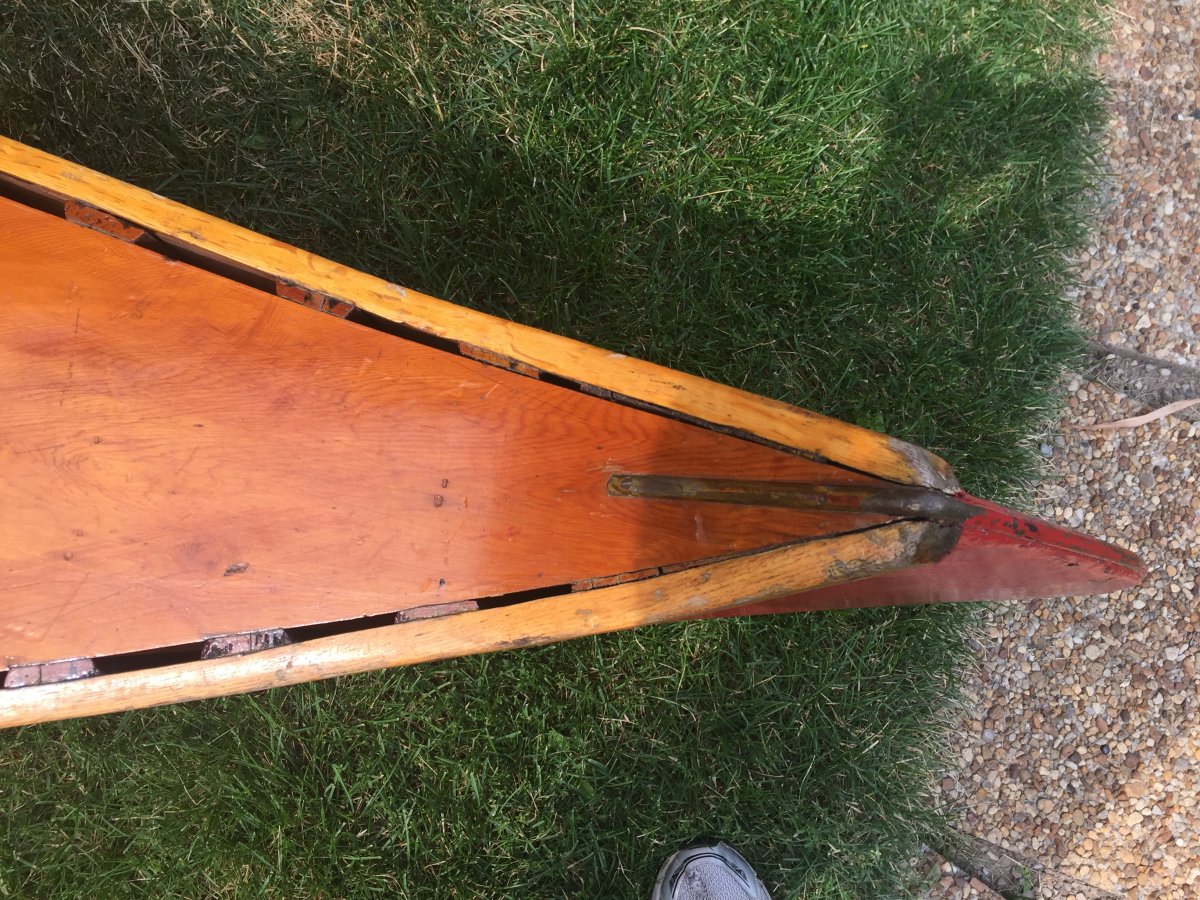

How's that glass pulling going? Glad I passed, this turned up. 60 or 61 Peterborough Iroquois , chestnut maiden branded as a Pete. Stripped too many glass boats in the past, wasn't up to the task!

That's a nice one, and in great shape. I'm just back from a Velo Quebec bike tour in La Beauce, so I haven't had time to make more progress. But I'll get back on it this week. It's a little more than half stripped now, and the planks appear to be in good shape. The smell of hot resin is turning out to be less than pleasant.
