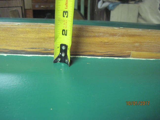

Back at work on this UFO. Still think this is a Peterborough canvas canoe built on a wide board form. I started painting and added the keel.
I put a keel 1 5/8th" and two inches deep. this is my best guess about what it originally had. I've not put bilge keels yet. I may not.
