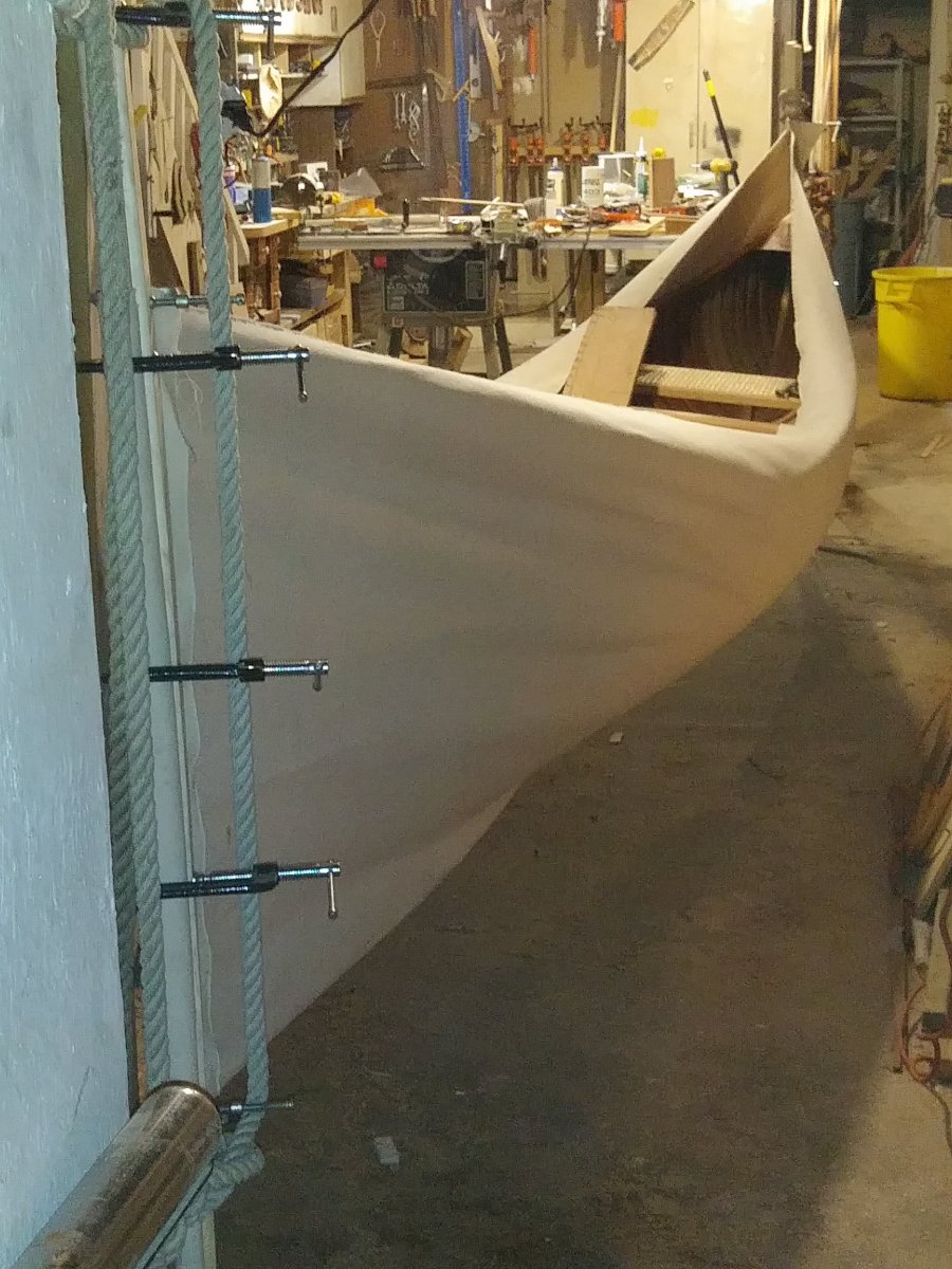

We, now just me, used 4x4 angled from the floor and against a floor joist.
Last winter I finally got around to recanvassing 15ft canoe,. The sign only use one 4 by 4 and the chimney I don't know if you can make it out in the photo,. I'm always mildly amazed at how much canvas stretches!
