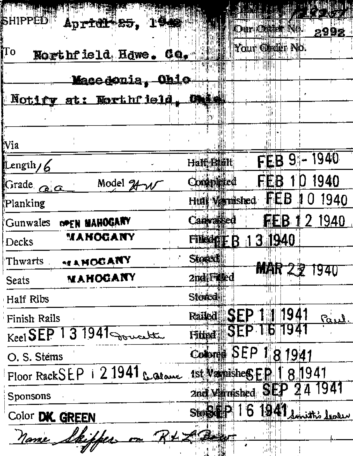

Shellac?
Thanks very much Benson. Hey, I just noticed something on this build record. Under the "Stored" Section and after the "2nd Varnished" section it appears that "A Shellac" is hand written in. Do you know if Old Town offered amber shellac bottoms that some Maine Guides preferred?

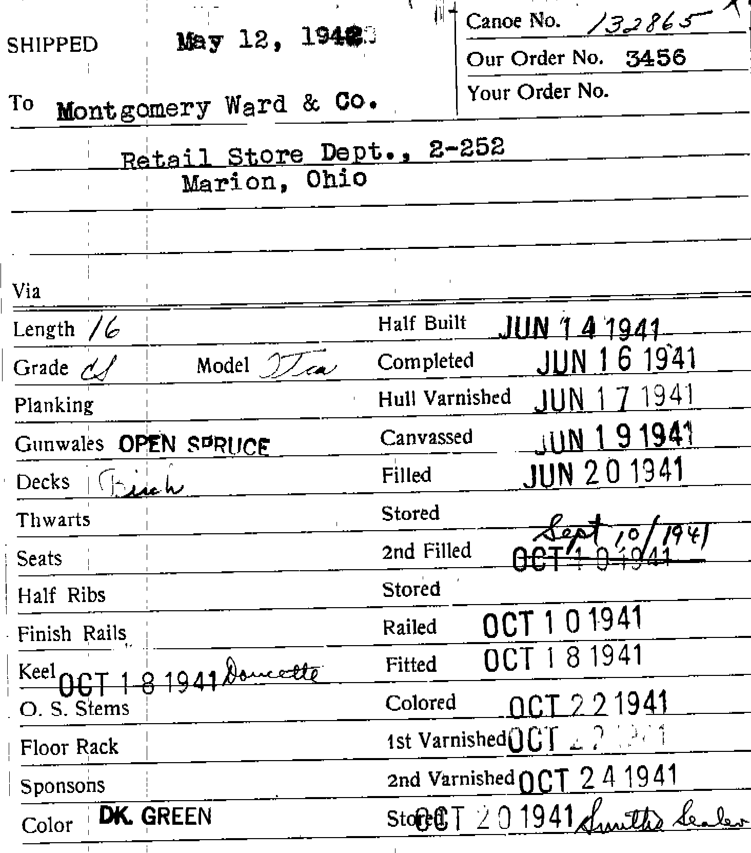

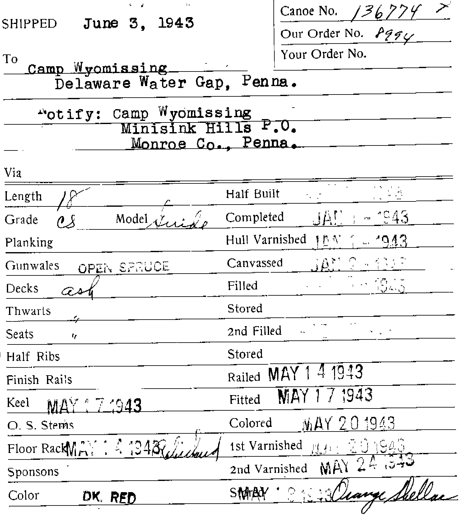

Old Town would generally do almost anything that a customer was willing to pay for. However, shellac bottoms do not appear to have been a frequent request. Orange shellac does appear to have been a common addition during this time period as shown at http://forums.wcha.org/attachment.php?attachmentid=835&d=1129139469 and in the other two records attached below. The dates indicate that this was applied before the interior varnish or exterior colored paint so this may not have been a traditional shellac bottom. This notation was very common on records from 1943 and 1944 so it may have been an adjustment that was made due to the limited supplies available during the war. The records at http://forums.wcha.org/attachment.php?attachmentid=565&d=1120874842 and http://forums.wcha.org/attachment.php?attachmentid=376&d=1115086446 indicate that "Smith's Sealer" was used in place of orange shellac in 1941.

I am also working on a 1943 OT Guide, It happens to be one of the canoes Benson referenced above, SN 136774. I believe the stem bands were the originals, and they were steel. All the tacks are brass. My Guide was canvassed in Jan. '43 and yours was done in March of the same year. I guess OT ran out of their supply of brass sometime aroung then. This is my first restoration. Stripping the varnish and shellac from the interior took longer and was more of a mess than I expected. What stripping method worked best for you? I still have a few areas I need to hit again.
