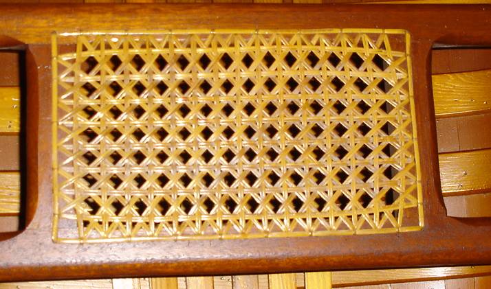

I have a '41 OT yankee and was wondering if anyone can tell me what the outwale dimensions are? I have the inwales and think they might be the same but want to make sure. Also I someone has pictures of the seats I would be thankful.
The outwales on our '36 Yankee are 7/8" wide & 15/16" high, and ends taper. Photos are original seat and trimmed piece of original seat rails. Seat rails are 7/8" x 1 1/2".
