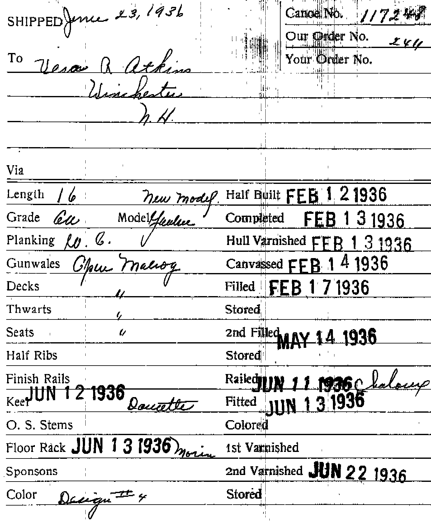

The following is a description of a floor rack from a 16 foot long, AA grade, Yankee built in 1936 that I just picked up (with many thanks to Fritz). The build record can be found at http://forums.wcha.org/attachment.php?attachmentid=217 if you want more details. This rack is 127 inches long and extends from stem to stem. It has five cross pieces at 7.5, 37.5, 63.5, 89.5, and 119 inches from the end. The widths of these cross pieces are 5, 11, 12, 11, and 5 inches respectively. Each cross piece appears to have been made out half ribs so they are beveled with the wide part on the bottom. These appear to be made out of white cedar. The long slats are roughly 1.25 by 0.25 inches and appear to be spruce. The intersection of each slat and cross piece is nailed with two round headed brass nails and clinched on the bottom. Feel free to reply here if you want additional details or pictures.
